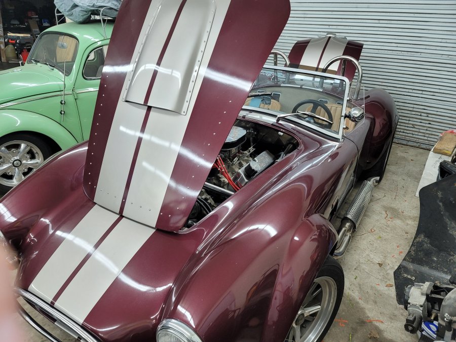

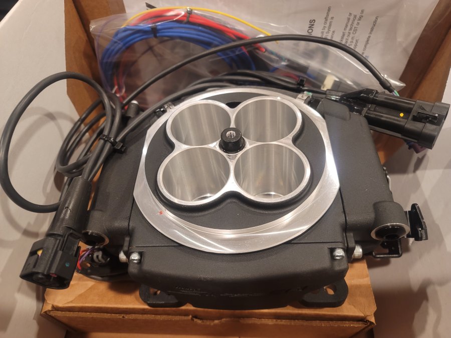

I'll break the ice for the 1st post in the Houston Chapter! I will be installing a new Holley Sniper EFI soon, if anyone want to be a part of the install. No set date yet. Work will be done at my House near Tomball.

Thanks for the info about the wire AWG and fuse issues. I will installing this on a Backdraft, the car has had a Quick Fuel carb for years. The carb is over fueling thru the vacuum secondaries causing the motor to run like trash. I have a few other projects that need finishing up and then i will be doing the swap and a new clutch.

The kit came with a new fuel pump and I will need to run a return line. If the wire AWG is too small worst case I canrun a new wire

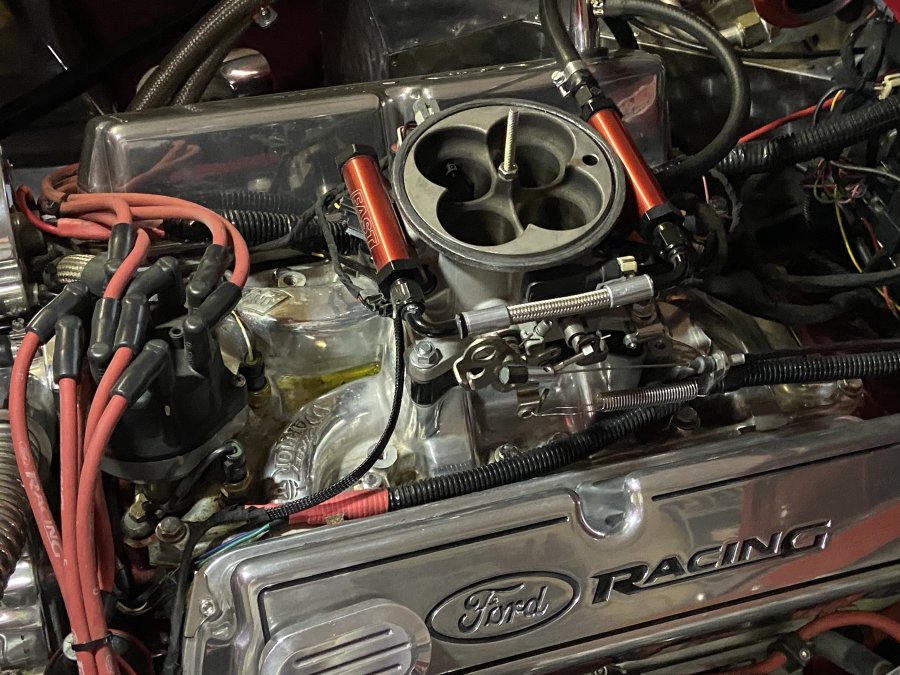

I installed FAST EZ on mine last October. It's a different car, you'll love it.
